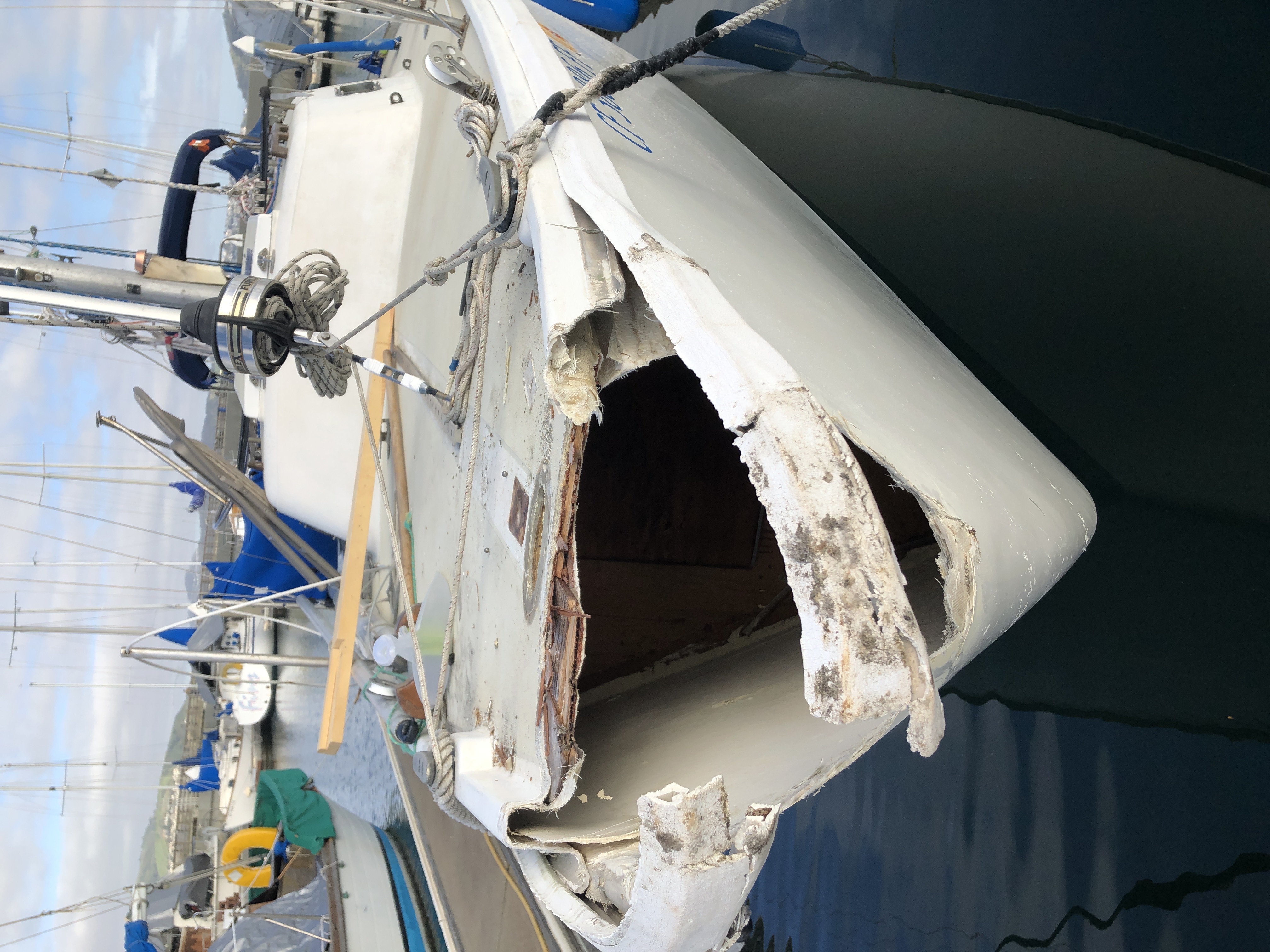

While I was searching for pictures for Mary I found this "before" picture of my friends boat after the wall hit him. I am still searching for the "after" picture, but it looked really good. The rail ended up looking way better than before, good as new...
Ouch!
